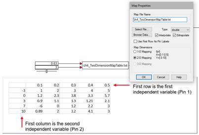

2-D Mapping: A two-dimensional map file has two independent variables and one dependent variable output. The first row contains the domain points for the first independent variable; and the first column (excluding the column member in row 1) represents the second independent variable. The position (1,1) must be left blank.
Like one-dimensional mapping, the independent variable values must be either monotonically increasing or decreasing.
Lines that are prefaced with a semi-colon (;) are treated as comments.
The numbers to the right of the 2-D Mapping parameter refer to the dimensionality and range of the map vector. For example, 10x50[10:20, -10:10] represents a 2-D table with 10 columns and 50 rows, where the minimum column is 10, the maximum column is 20, the minimum row is -10, and the maximum row is 10.

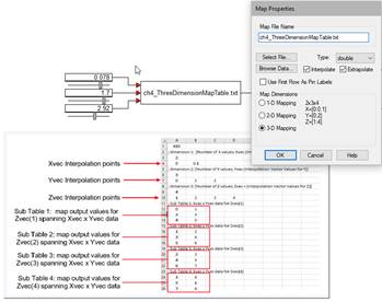

3-D Mapping: A three-dimensional map file has three independent variables and one dependent variable output. The format of the first seven lines is as follows:
1: Starts with #3D
2: Number of look-up values for dimension 1
3: Look-up values for dimension 1 (vector)
4: Number of look-up values for dimension 2
5: Look-up values for dimension 2 (vector)
6: Number of look-up values for dimension 3
7: Look-up values for dimension 3 (vector)
Lines 8 through n are elements of dimension 3 matrices of (dimension 1 columns) * (dimension 2 rows). Lines that are prefaced with double hyphens (--), double slashes (//), or commas (,) are treated as comments.
Dependent variables are linearly interpolated for independent variable values between map points, and linearly extrapolated for values beyond the bounds of the table using the last two points in the table. This feature can be used for static function approximation with measured data or for device calibration, such as thermocouple-voltage-to-temperature conversion.
Lines that begin with a double hyphen (--), semi-colon (;), or double slash (//) are treated as comments.

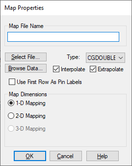

Map File Name: Specifies the name of the map file, or select one using Select File. Map files can be DAT, CSV, M, MAT, TXT, WAV, or XLSX files. To open the specified file with the default text editor, click Browse Data.
Use First Row As Pin Labels: If the first row in the data file is text, you must activate the Use First Row As Pin Labels. When activated, the text is used as labels on the block connectors.
