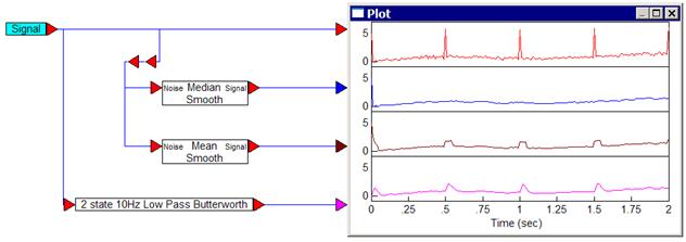

Notice the meanSmooth and filter outputs are affected by the outliers, while the medianSmooth ignores them.
