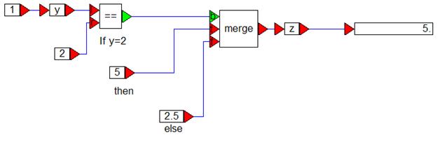

1. Simple If-Then-Else using merge block
merge blk example 1

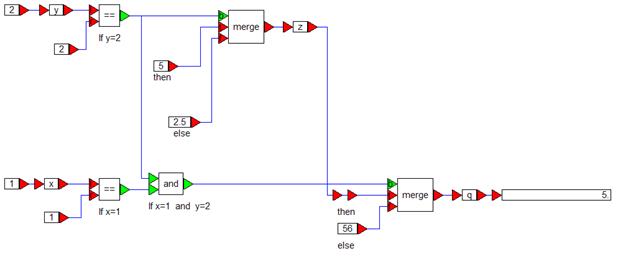

2. Cascading If-Then-Else using merges
merge blk example 2
