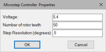

Number of Rotor Teeth: Indicates the physical number of teeth in rotor.
Step Resolution: Defines the control resolution. Units are in degrees.
Supply Voltage: Defines the RMS voltage level of the phase voltages through one cycle of motor rotation. Units are in volts.

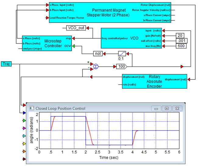

Example
Diagram name: Micro Step Controller
Location: Examples  > eMotors (Legacy) > Steppers
This example illustrates a typical application where a stepper motor is used in feedback with an optical encoder.
A Rotary Encoder block is used to directly measure shaft position of the stepper motor. Angular displacement is compared against the trajectory. The error is amplified with a high gain to saturate the VCO (Voltage Controlled Oscillator) input and drive the motor to the maximum specified slew rate (600 steps/sec). Since only proportional control is used, the VCO quickly desaturates as the motor closely approaches the target trajectory. The sign of the comparator provides direction control as a 0 or 1 in the Microstep Controller.
In this example, microstep resolution is set at 0.1o. Closer examination of the rotor position shows a limit cycle once the motor reaches its trajectory. This hunting could be eliminated using deadband or other logic mechanisms that could easily be implemented using other standard Embed blocks.
The disadvantage of this type of controller is the expense and complexity of using an encoder for feedback and having to use additional control logic. The advantage is that if the motor inadvertently loses step, it will recover and eventually reach the targeted command. Stepper motors may sometimes lose step if external disturbance torques are encountered that exceed design torque, or if the motor is slewed too quickly.
