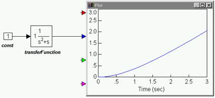

Consider a type 1 system with the open-loop transfer function:
as shown below:
To generate the Nyquist plot
1. Create the above diagram using a const, transferFunction, and plot block.
2. Enter the following polynomial coefficients to the transferFunction block:
Numerator: 1
Denominator: 1 1 0
Note: Always leave spaces between coefficient values.
