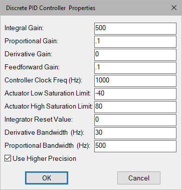

The PID Controller-Digital block models a PID compensator as if implemented on a processor using either backward-rectangular approximation or the higher precision trapezoidal method for integration and filtering. This block provides anti-windup of the integrator component by separately calculating the PDF components, comparing this to the actuator saturation limits, and setting integration limits at each time step. PIDF, IF, PD, I, or P control can be implemented by choosing 0 gains for the unused components.
Band limiting filters are provided for the proportional and derivative components. Derivative bandwidth specification guarantees no more than 10o phase difference at that frequency as compared to true derivative. A rooftop filter is used to provide roll-off at high frequency. A simple second order low pass filter is used to limit proportional component bandwidth.
Actuator High Saturation Limit: Defines the upper operating limit of the device connected to the PID output.
Actuator Low Saturation Limit: Defines the lower operating limit of the device connected to the PID output.
Controller Clock Frequency: Sets the update rate of the PID compensator in hertz.
Derivative Bandwidth: Indicates the limiting frequency of the derivative component of control in hertz.
Derivative Gain: Indicates the multiplying factor for the derivative component of control.
Feed forward Gain: Indicates the multiplying factor for the control component that feeds directly from the input to the output of the PID controller.
Integral Gain: Indicates the multiplying factor for the integral component of control.
Integrator Reset Value: Defines the value at which the integrator is initialized upon setting the Integrator Reset input high.
Proportional Gain: Indicates the multiplying factor for the proportional component of control.
Proportional Bandwidth: Indicates the limiting frequency of the proportional component of control in hertz.
Use Higher Precision: When this parameter is activated, Tustin’s method of integration is used for higher precision in integration and filtering. When this parameter is de-activated, backward rectangular integration is selected.

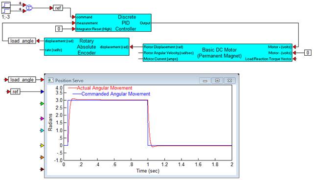

Diagram name: Discrete PID Controller
Location: Examples > eMotors (Legacy) > Brush DC
The following example illustrates the use of the PID compensator in shaping the dynamic response of a position control loop in feedback with a DC torque motor and rotary optical encoder. A profiler issues a command to move from 0 to 3 rad, and back to 0.
