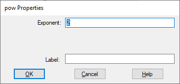

Exponent: Specifies the power to which the input signal is raised. If the input signal is negative, the exponent must be an integer; otherwise, a domain error occurs. The default is 2. You can also enter a value in hexadecimal notation or as a C expression.
