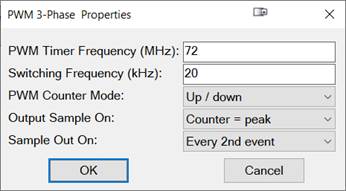

Description: The PWM-3 Phase block is used for generating 3-phase PWM signals, with switching included.
Graphical user interface, text, application
Description automatically generated
Output Sample On: Sets the moment in the PWM period at which a unit pulse will be generated at the output pin.
PWM Timer Frequency (MHz): Specifies the timer frequency used for PWM generation. This will determine the PWM resolution in MHz.
PWM Counter Mode: Selects the counter mode of the PWM generation. Note that up/down count mode halves the switching frequency.
Sample Out On: Specifies the frequency of the sample pulse.
Switching Frequency (kHz): Specifies the required PWM switching frequency in kHz.
