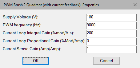

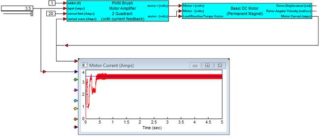

Diagram name: PWM Brush Amplifier 2Q WCF
Location: Examples > eDrives and Systems > eMotors (Legacy) > Brush DC
This example illustrates how the PWM amplifier can be used to directly regulate a set current in a DC motor. Such a control loop may be used to control against torque disturbance since torque is directly proportional to motor current. Here the supply voltage is set at 180 V, and PWM frequency is 9000 Hz. Proportional gain is set at 0, so the control is pure integral with a gain of 50. The current sense gain is 1, so the average controlled current should approach the set current of 1.5 amps.
