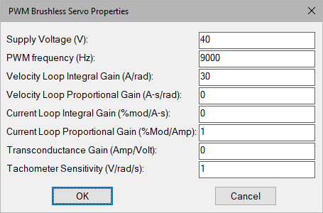

Current Loop Integral Gain: Indicates the current loop PI controller integral gain. This parameter typically sets the steady-state tracking accuracy of the current control. Units are in 1/sec.
Current Loop Proportional Gain: Indicates the current loop PI controller proportional gain. This parameter typically sets the speed (bandwidth) of the current control.
PWM Frequency: Sets the carrier frequency for the PWM in hertz. Note that the reciprocal of the simulation step size (simulation frequency) must be equal to or greater than the carrier frequency to perform a proper simulation.
Supply Voltage: Specifies the voltage level for PWM pulses in volts. A positive voltage produces clockwise rotation of the motor. A negative voltage produces counterclockwise rotation.
Tachometer sensitivity: Lets you rescale tachometer readings from V to rad/sec. For example, if the known tachometer sensitivity is 200V/rad/sec, enter this number to scale the reading back to rad/sec.
Transconductance Gain: Sets the current to voltage gain of the current controller. Units are in amps/V.
Velocity Loop Integral Gain: Indicates the velocity loop PI controller integral gain. This parameter typically sets the steady-state tracking accuracy of the speed control. Units are in amps/rad.
Velocity Loop Proportional Gain: Indicates the velocity loop PI controller proportional gain. This parameter typically sets the speed (bandwidth) of the velocity control. Units are in Amp-sec/rad.

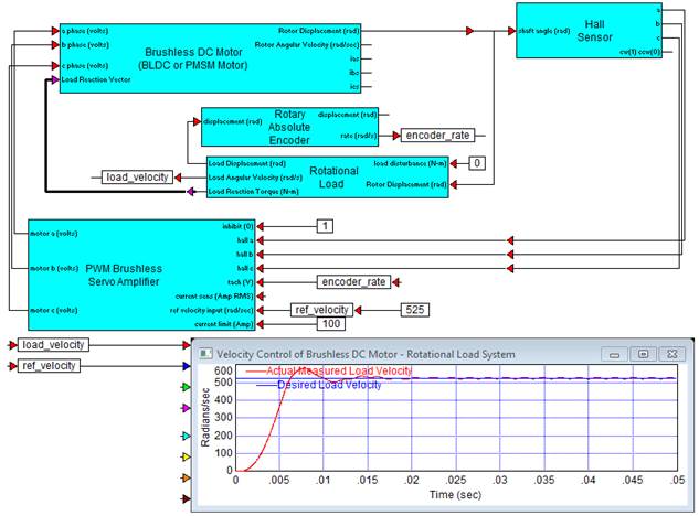

Diagram name: Brushless PWM Servo AMP
Location: Examples > eDrives > eMotors (Legacy) > BLDC
The following example demonstrates the application of PWM Brushless Servo Amplifier block being used to control velocity of a brushless DC motor in feedback with an encoder. Hall sensors are used for commutation of the motor and are connected between the motor shaft and the PWM amplifier. Note that the encoder measures rotor shaft displacement and velocity is estimated for feedback.
