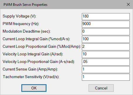

Current Loop Integral Gain: Typically sets the speed and tracking accuracy (bandwidth) of the current control loop. Units are 1/sec.
Current Loop Proportional Gain: Typically sets the damping of the current control loop.
Current Sense Gain: Sets the current sensing device. Units are in amps/amp.
Modulation Deadtime (sec): Sets the switching deadtime between H-bridge device pairs. Note that the value of deadtime should be significantly smaller than the PWM frequency, but larger than the specified simulation frequency rate. Units are in seconds.
PWM Frequency: Sets the carrier frequency for the PWM in hertz. Note that the reciprocal of the simulation step size (simulation frequency) must be equal to or greater than the carrier frequency to perform a proper simulation.
Supply Voltage: Sets the voltage level output of the PWM in volts.
Tachometer sensitivity: Allows you to rescale tachometer readings from volts to rad/sec. For example, if the known tachometer sensitivity is 200 volts/radian/sec, enter this number into the tachometer sensitivity setting of the PWM Brush Servo Amplifier block to scale the reading back to radians/sec.
Velocity Loop Integral Gain: Typically sets the speed and tracking accuracy of the speed control loop. Units are in amps.
Velocity Loop Proportional Gain: Typically sets the damping of the speed control loop. Units are in amp-sec.

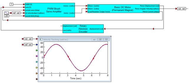

Diagram name: Brush PWM Servo AMP
Location: Examples > eDrives > eMotors (Legacy) > Brush DC
This example illustrates the single controller package solution for servo tracking control of a DC brush motor with current feedback. A rotary encoder provides the velocity feedback measurement.
