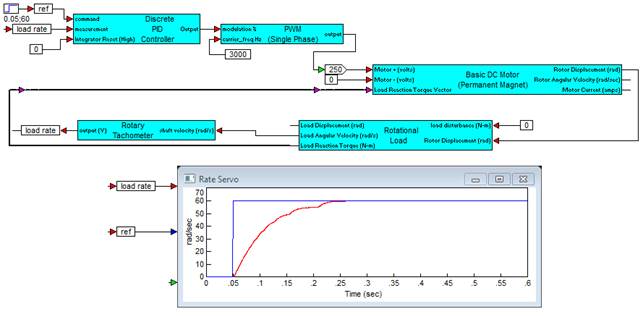

Example
Diagram name: PWM Single Phase
Location: Examples > eDrives > eMotors (Legacy) > Brush DC
