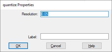

Resolution: Specifies the value to which the input signal is rounded or truncated. The default is 0.05. You can also enter a value in hexadecimal notation or as a C expression.
