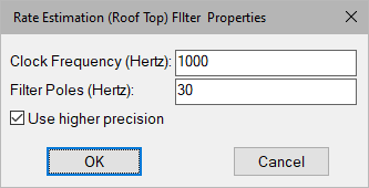

Clock Frequency: Defines the processor rate for rate estimation in hertz.
Filter Pole: Defines the center frequency of the rooftop filter in hertz. Select a frequency 30 times larger than the highest frequency for estimation of derivative.

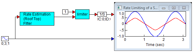

The following example demonstrates how to use a rooftop filter to limit the rate on a signal. The rooftop filter is first used to determine the derivative (rad/sec) of the angular displacement input signal (rad). The rate is limited, and then converted back to radians by integration. The resulting signal shows limiting when the input signal exceeds the rate limit.
