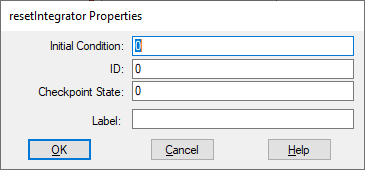

Checkpoint State: Contains the value of the integrator state at the checkpoint. If you have not checkpointed your simulation using the System > System Properties command, the default value is 0. You can also enter a value in hexadecimal notation or as a C expression.
ID: Represents an identification number for the block. This number keeps track of the state number that Embed assigns to the integrator. The number of states in any diagram equals the number of integrators. The default value is 0.
Initial Condition: Indicates the initial value of the integrator upon simulation start-up. This parameter can be overridden if  is non-zero on the first step of the simulation. The default is 0. You can also enter a value in hexadecimal notation or as a C expression.
