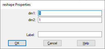

Description: The reshape block re-dimensions matrix input. The data remains the same, but the dimensions change. If the matrix dimensions are too large, zeros are padded in the extra cells. If the matrix dimensions are too small, the matrix data is truncated.
Dim1: Indicates the x dimension of the matrix.
Dim2: Indicates the y dimension of the matrix.
