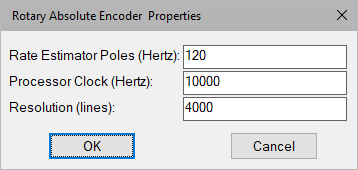

Processor Clock: Defines the processor clock rate for rate estimation.
Rate Estimator Poles: Defines the bandwidth of rate estimation. This parameter typically requires a trade-off between rate estimation accuracy and noise. Units are in hertz.
Resolution: Indicates the total number of lines per revolution.

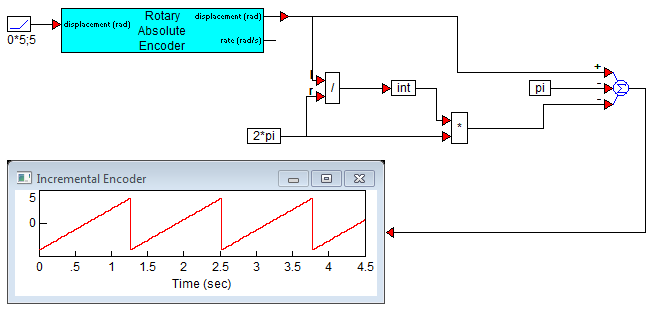

Example
Diagram name: Rotary Absolute Encoder
Location: Examples > eDrives > eMotors (Legacy) > Sensors
The Rotary Absolute Encoder block simulates an incremental encoder with an assumed built-in counter providing undisturbed unlimited displacement output. A true absolute encoder that uses some type of binary coded scales will reset to 0 position after one complete revolution, and will usually issue an index signal at the 0 position to signal an external counter or processor. In cases where a simulation of an absolute encoder is needed, a simple block construction can be made to calculate absolute angular position using a modulo 2π conversion. The following simulation example illustrates this method. In this example, π is subtracted at the output to provide ±π measurements.
