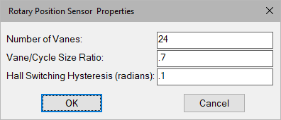

Number of Vanes: Indicates the number of vanes on the interrupter wheel.
Vane/Cycle Size Ratio: Indicates the proportion of space occupied by the vane interrupter vs. total cycle. A cycle is the size of the combined window and vane.
Hall Switching Hysteresis (radians): Sets the Hall device switching hysteresis characteristic. Units are in radians.

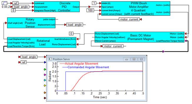

The example below shows a brush DC motor model controlled by a PI compensator in feedback with the Rotary Position Sensor block.
