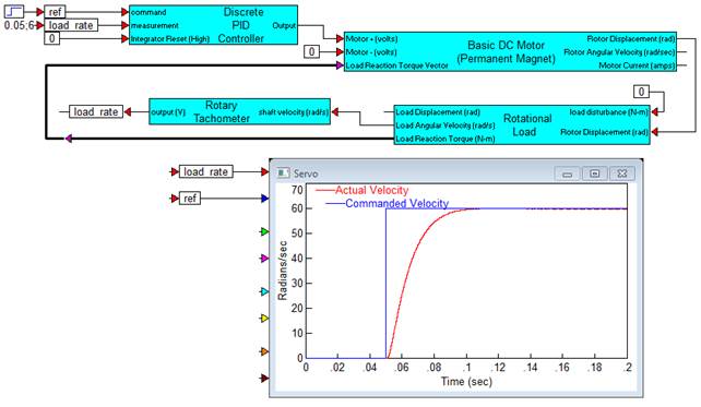

The following example shows velocity feedback control of a permanent magnet DC motor. A load is coupled to the motor by a gear ratio of 0.5, thus multiplying motor torque by a factor of 2. Load velocity is measured by a tachometer with a ripple factor of 0.1 VRMS and 24 commutator segments. The plot zooms in on the velocity as it approaches steady state (60 radians/sec). The ripple can be seen superimposed on the response.
