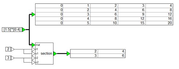

Removing a submatrix
In the block diagram below, a 5 x 5 matrix is generated and shown in the display block. The subsection to be removed is a 2 x 2 matrix between row 2, column 2 and row 3, column 3.
