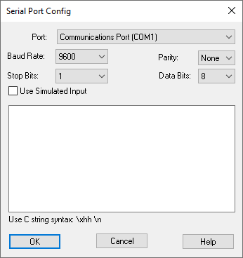

Description: The Serial Config command is used to set the serial bit rate, parity, byte size and port.
Baud Rate: Specifies the baud rate.
Data Bits: Sets the number of data bits.
Parity: Sets the parity.
Port: Specifies the port.
Stop Bits: Specifies the stop bits.
Use Simulated Input: Specifies that simulated data is used. This parameter is useful when testing an algorithm that checks data. When this parameter is not activated, real data is used.
