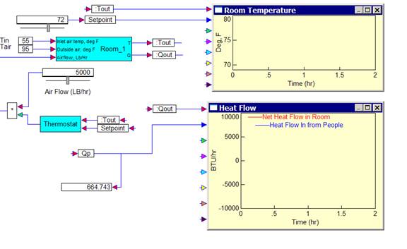

Setpoint
The setpoint is controlled by a dynamic slider block that specifies the desired temperature in the room.
You can adjust the temperature as the simulation progresses by sliding the gray rectangular box to the right or left. As you change the setpoint, you can observe how quickly the model responds to the changes. The temperature is initially set to 72 degrees Fahrenheit. The allowable temperature range is 50 to 85 degrees Fahrenheit.
Thermostat
The thermostat is a simple ON/OFF control with hysteresis. It allows fluctuation of 1 degree above the setpoint before turning on the Air Flow to blow cool air into the room. The Air Flow remains on until the temperature drops 1 degree below the setpoint. The temperature at which the thermostat turns ON and OFF around the setpoint is specified by the deadband setting in the thermostat subsystem. It is initially set to 2. You can change the setting to see how the model responds.
Air Flow
The Air Flow is controlled by a dynamic slider block that blows cool air into the room when the thermostat turns ON.
Room
The room is modeled as a simple box with heat flowing in through the walls and heat mass in the room contents and interior walls. There is no heat storage in the room walls and the room air is completely mixed.

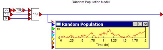

People
The number of people entering and exiting the room is a subsystem within the Room subsystem. The number of people is generated by integrating a Gaussian random number function.
Running the simulation
As you run the simulation, you can immediately see the how the temperature fluctuates as people enter and exit the room, as well as when and for how long cool air is blown into the room. By varying the setpoint and air flow, you can see how they affect the time it takes to cool down the room.
