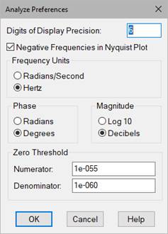

To specify frequency units
1. Choose Analyze > Preferences.
2. Specify the units.
•For the frequency units for phase and magnitude plots, choose Radians/Second or Hertz under Frequency Units.
•For the phase unit in frequency response phase plots, choose Radian or Degrees under Phase.
•For the magnitude unit in frequency response magnitude plots, choose Log 10 or Decibels under Magnitude.
3. Click OK, or press ENTER.
