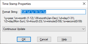

Format String: Specifies the format for displaying the date and time.
Update Frequency: Specifies when the time stamp is applied.

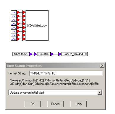

If you want to log data acquisition results in a file where the file name is tied to the date, you can use the timeStamp block in conjunction with the export block, as shown below.
Here the variable DAQfile expands to Jan02_162454TC, resulting in the complete file name Jan02_162454TC.csv.
