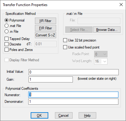

When you simulate the block diagram, Embed numerically solves the transferFunction block. The transferFunction block’s Properties dialog box allows you to control how the numerator and denominator polynomials are entered.

Discrete transfer function: To implement a discrete transfer function, activate the discrete parameter and enter the discrete coefficients directly to the Numerator and Denominator parameters. Conversely, you can enter continuous coefficients and then press Convert S->Z to perform a Tustin transform of S to Z domain.
Digital filter design: The transferFunction block supports IIR and FIR digital filter design.
Display Filter Method Displays the filter specification on the block. When Display Filter Method is not activated, Embed displays the polynomial coefficients.
Gain: Indicates the transfer function gain. If the leading terms of the numerator and denominator coefficients are not unity, Embed will adjust the gain to make it so. The default value is 1.
Initial Value: Specifies initial values for the states in the block. The values are right-adjusted. The right-most value corresponds to the lowest order state. Unspecified states are set to 0. The initial value can be a variable.
.mat/.m File: Lets you specify the name of the M or MAT file to be used as input to the transferFunction block. If you do not know the name, click Select File to find it.
Denominator: Indicates the denominator polynomial for the transferFunction block. Separate values with a space. Embed determines the order of the transfer function by the number of denominator coefficients you enter. For example, an nth order transfer function will have n + 1 coefficients. You can specify the denominator as a matrix expression.
Numerator: Indicates the numerator polynomial for the transferFunction block. Separate values with a space. You can specify the numerator as a matrix expression.
Radix Point: Sets the binary point.
Discrete: Indicates a discrete Z-Domain transfer function. Enter the coefficients directly into the Numerator and Denominator parameters. Enter the time step for the discrete transfer function in the dT box. By default, Embed uses the step size established with the System > System Properties command. When Discrete is de-activated, a continuous transfer function is created. For information on resolving issues with discrete transfer function behavior, see the Embed discrete transferFunction Forum entry.
dT: Specifies the time step for the discrete transfer function. By default, Embed uses the step size parameter from the System > System Properties command.
Poles and Zeros: Lets you enter a transfer function via zeros and poles in the Numerator and Denominator boxes, respectively. Enter each root in the following format:
(real-part, imaginary-part)
For large order systems, poles and zeros is more numerically accurate.
Polynomial: Indicates that the transfer function is to be specified as numerator and denominator polynomials. Supply the numerator and denominator polynomials and gain under the Polynomial Coefficients group box. .mat file indicates that the transfer function is to be specified as a MAT file. Specify the name of the MAT file in the .mat/.m File group box. .m file indicates that the transfer function is to be specified as an M file. Specify the name of the M file in the .mat/.m File group box.
Tapped Delay: Provides tapped delay implementation for high-order FIR filters.
Use 32-Bit Precision: Simulates the behavior of the transfer function at 32-bit precision. Normally, all Embed blocks are 64-bit precision. This parameter allows you to simulate the effect of code running on a floating point 32-bit target.
Use Scaled Fixed Point: When targeting a fixed-point processor, such as a TI C2000, activate this parameter. Embed uses scaled fixed-point internal operations and will generate scaled fixed-point code.
Word Length: Sets the word size for the target architecture.
Convert S to Z button: Uses bilinear transformation to convert a continuous transfer function to an equivalent discrete transfer function with a sampling interval of dT.
Convert Z to S button: Uses bilinear transformation to convert a discrete transfer function to an equivalent continuous transfer function.
FIR Filter button: Opens the FIR Filter Setup dialog box to construct Regular Finite Impulse Response filters, differentiators, and Hilbert Transformers.
IIR Filter button: Opens the IIR Filters Setup dialog box to design a suitable filter using analog prototypes.
