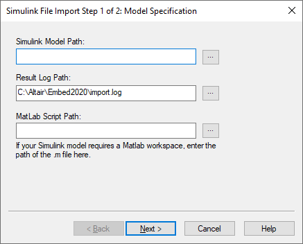

1.    Choose Tools > Import > Simulink Diagram.
The Simulink File Import Step 1 of 2 dialog box appears.
2.    Do the following:
a.    In the Simulink Model Path box, enter the name of the MDL file to be translated, or click to locate the file.
b.    In the Result Log Path box, enter the name of the LOG file that will store all error, warning, and confirmation messages issued during the translation. Click … to set the name and path information for the LOG file.
c.     In the MatLab Script Path box, enter the full path for the M file, if necessary, or click to locate the file.
d.    Click Next to initiate the translation.
