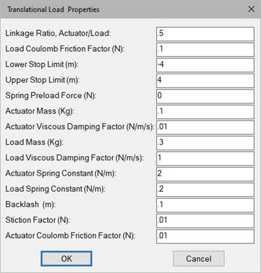

Actuator Coulomb Friction Factor: Indicates the constant directional sensitive force (Coulomb Model) in N. Enter 0 for no Coulomb loading.
Actuator Mass: Indicates the actuator moving mass in kg.
Actuator Spring Constant: Indicates the proportional spring factor that relates the position of the actuator moving mass to the restoring force. Enter 0 (zero) if there is no spring in the load.
Actuator Viscous Damping factor: Indicates the proportional factor of the actuator that relates the velocity to the dissipative force. Enter 0 for no viscous damping.
Backlash: Introduces hysteretic backlash in linkage mechanism in units of m. Enter 0 for no backlash.
Linkage Ratio Actuator/Load: Defines the mechanical advantage factor between the actuating device and load. Enter 1 for direct coupling between actuator and load; enter a number less than 1 to multiply force; and enter a number larger than 1 to multiply speed.
Load Coulomb Friction Factor: Indicates the constant load directional sensitive force (Coulomb Model) in N. Enter 0 for no Coulomb loading.
Load Mass: Indicates the load moving mass in kg.
Load Spring Constant: Proportional spring factor that relates the position of the load to the restoring force. Enter 0 if there is no spring in the load.
Load Viscous Damping factor: Indicates the proportional load factor that relates the velocity to the dissipative force. Enter 0 for no viscous damping.
Lower Stop Limit: Indicates the minimum hard stop limit in m.
Spring Preload Force: Indicates the initial restoring (bias) force introduced by load spring. Enter 0 if there is no preload in the spring.
Stiction Factor: Sets the 0 speed, static friction force of the actuator in N.
Upper Stop Limit: Indicates the maximum hard stop limit in m.

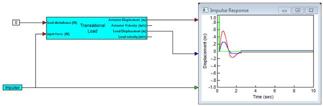

The example shown below is the impulse response of translational masses connected by a gear of ratio of 1:2 with backlash. Each mass is suspended by springs and bearing surfaces that are modeled by a combination of Coulomb, stiction and viscous friction forces. At 0.2 sec, a 10 N impulsive force is exerted on the actuator mass and the assembly can oscillate freely under its own suspension. The topping off of the geared mass is caused by the backlash. Rather than settling to the 0-equilibrium position, both stiction and backlash cause a steady-state offset in the position of the masses.
