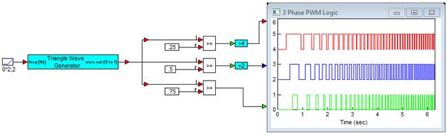

In this example, three comparators are used to create logic states for three-phase PWM from the triangle wave generator. A null offset of 1 Hz was used in this example.
