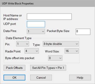

Description: The UDP Write block writes data to the UDP port on the Ethernet.
Data Element Type: Controls the data type of each output connector and the offset into packet.
Data Pins: Specifies the number of input connectors (128 max).
Host Name or IP Address: Specifies the IP address or host name of target.
Packet Byte Size: Specifies the size of the packet to be written (512 bytes max).
Pack Offsets: Iterates over all connectors and assigns consecutive ascending offsets to each connector.
Set All Pin Types = 1: Sets the data type of all connectors to be same as connector 1, and then performs a Pack Offset.
UDP Port: Specifies the port to exchange data. It is recommended to use ports greater than 49151.
