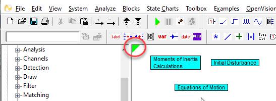

You use tags to mark locations in a diagram that you want to find quickly. Embed marks the location with a green triangular tag in the upper left-hand corner of the current level of the diagram. The tag does not appear when you print the diagram.
