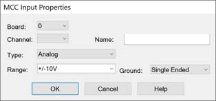

To specify MCC Input block properties
1. Choose Blocks > Real Time and drag an MCC Input block into the work area.
2. Choose Edit > Block Properties and click the MCC Input block, or right-click the MCC Input block.
The MCC Input Properties dialog box appears.
3. Do one or
more of the following:
Use this parameter |
To |
Board # |
Select the installed Measurement Computing board. Text that describes the board will appear to the right. |
Channel |
Indicate the analog, digital, or counter channel. For each 8255 unit, channels 0 – 7 correspond to Port A; channels 8 – 15 correspond to Port B; channels 16 – 23 correspond to Port C. Note that multiple digital devices are treated like one large device. Thus, digital channel 24 corresponds to Port A bit 0 on the second 8255 digital device. |
Type |
Indicates whether the board is analog, digital, or counter channels. The channel count is adjusted to reflect the channel type. |
Name |
Provide a unique name for your MCC Input block. |
Range |
Indicate the voltage range for the I/O board. |
Ground |
Indicate whether the I/O board is single-ended (that is, single ground for all channels) or differential (that is, floating ground). If you choose differential, the channel count is adjusted to reflect the channel type. |
4. Click OK, or press ENTER.
