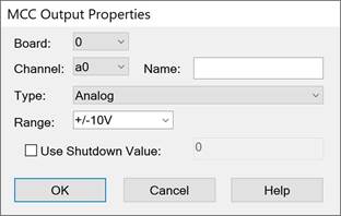

Description: Through the Setup dialog box for the MCC Output block, you define the base address and channel number to which the pulse width modulated waveform is sent. You also use the Setup dialog box to set the clock frequency and to provide the PWM block with a unique name.
To specify MCC Output block properties
1. Choose Blocks > Real Time and drag an MCC Output block into the work area.
2. Choose Edit > Block Properties and click the MCC Output block, or right-click the MCC Output block.
The 9513 PWM Counter Output Setup dialog box appears.
3. Do one or
more of the following:
Use this parameter |
To |
Board # |
Select the installed Measurement Computing board. Text that describes the board will appear to the right. |
Channel |
Indicate the analog, digital, or counter channel. For each 8255 unit, channels 0 – 7 correspond to Port A; channels 8 – 15 correspond to Port B; channels 16 – 23 correspond to Port C. Note that multiple digital devices are treated like one large device. Thus, digital channel 24 corresponds to Port A bit 0 on the second 8255 digital device. |
Type |
Indicates whether the board is analog, digital, or counter channels. The channel count is adjusted to reflect the channel type. |
Name |
Provide a unique name for your MCC Input block. |
Range |
Indicate the voltage range for the I/O board. |
Use Shutdown Value |
Present the indicated value to the output port when the simulation is stopped. |
4. Click OK, or press enter.
