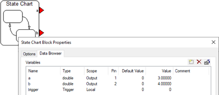

•It must be defined in the Data Browser tab for the State Chart Block Properties dialog box
•It has Local scope
•Its data type is Trigger

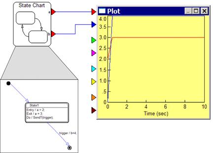

The following example uses a local variable named trigger and the SendT() function to control the trigger.
When the simulation starts, the initial state transitions to State1, and the variable a = 2. The trigger is executed if the state is active and remains active for the current simulation step. When the trigger goes high, State1 transitions to the final state. On State1 exit, a = 3. The variable b shows that the transition to final state occurred.
