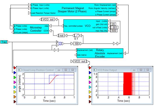

Diagram name: VCO Stepper Control
Location: Examples > eDrives > eMotors (Legacy) > Steppers
This example illustrates a typical application where a stepper motor is used in feedback with an optical encoder. The output of the VCO is plotted in a plot block.
