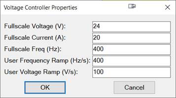

All inputs are divided by their respective full-scale values to derive normalized values. For example, ud_n = ud_ref/V_fs, where ud_ref is the user input and V_fs is the full-scale voltage.
Fullscale Current (A): Indicates the full-scale current value for normalization.
Fullscale Freq (Hz): Indicates the full-scale frequency value for normalization.
Fullscale Voltage (V): Indicates the full-scale voltage value for normalization.
User Frequency Ranp (Hz/s): Indicates the safety limit to avoid sudden jerks in the input frequency values.
User Voltage Ramp (V/s): Indicates the safety limit to avoid sudden jerks in the input voltage values.
