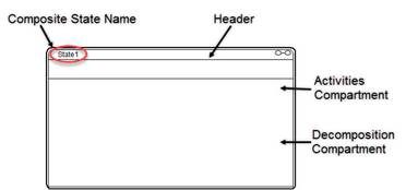

A composite state has the following areas:

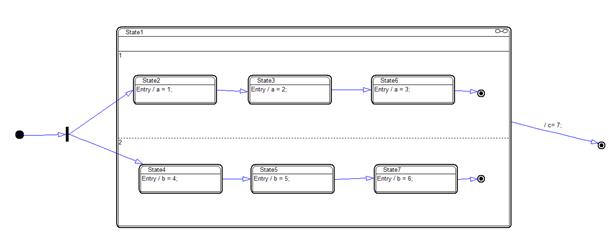

When you create regions, those regions are in the decomposition compartment of the composite state. Embed provides each region with a number. The number indicates the evaluation order.
The above composite state has two regions. The top region is labeled 1, indicating it will be evaluated first. For more information on how Embed evaluates composite states, see “Evaluating an orthogonal composite state.”
