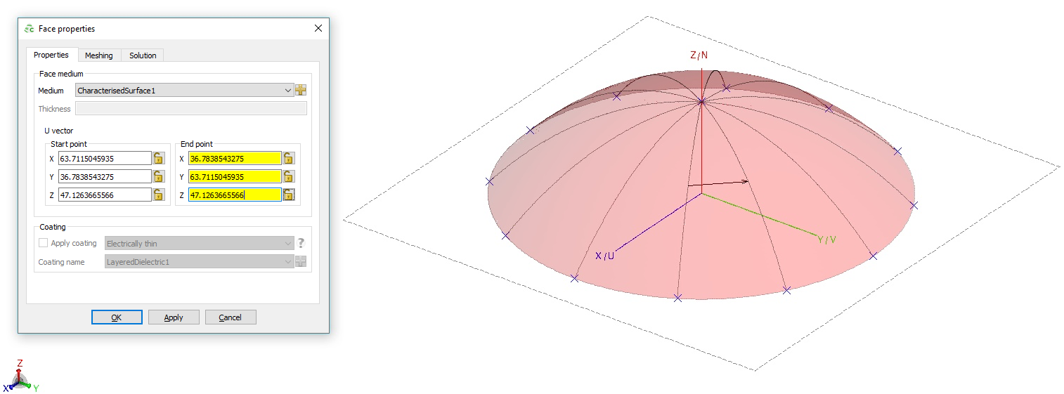

  1. Select a face to apply a characterised surface.
  2. From the right-click context menu, select Properties.
  3. On the Modify Face dialog, click the Properties tab.
    Figure 1. The Modify Face dialog (Properties tab).
  4. In the Medium drop-down list, select the characterised surface to apply to the face.
The U-Vector is defined as the reference direction projected onto the face.
  1. Under U-Vector, specify the start point and end point for the U-Vector. The vector is not required to be exactly in the plane of the face, since it is projected onto the face, but it should be approximately parallel to the face.
    Figure 2. The display in CADFEKO when setting the U-Vector. Opacity settings were modified in order to see the U-Vector preview.
