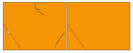

The Remove small features tool attempts to remove small features, such as edges, faces, spikes and gashes.
Figure 1. A model containing small entities (left) and the model after the small entities were removed (right).
