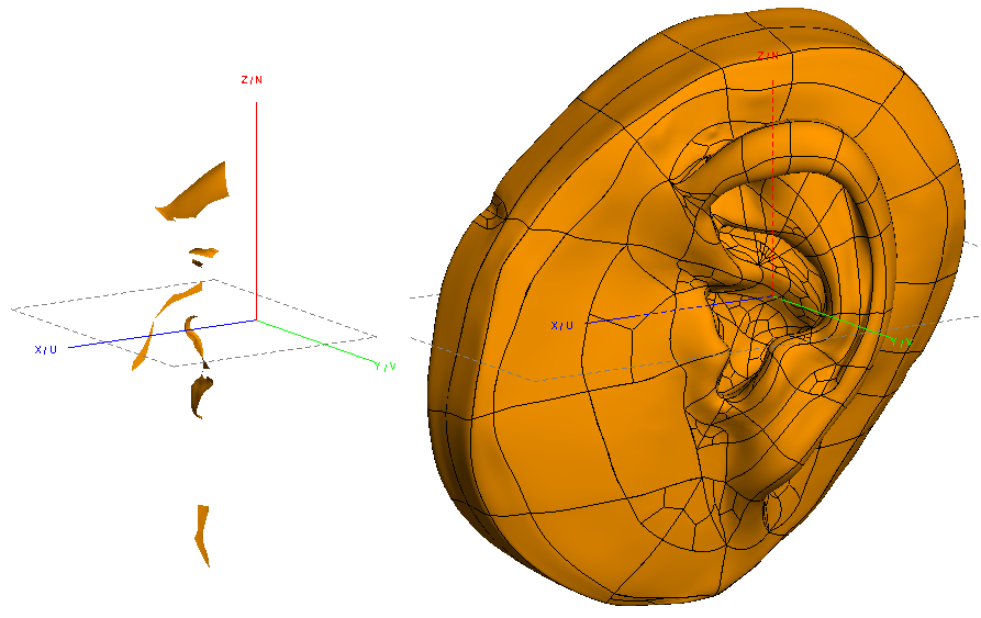

Repair Part
The Repair part tool heals a body in an attempt to create a valid geometry part.
The tool attempts to fix the following:

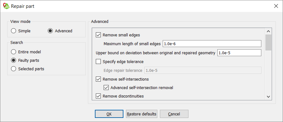

On the Transform tab in the
Repair group, click the Repair Part icon.
Advanced settings
- Remove small edges
- Edges are removed whose arc length is less than the Maximum length of small edges.
- Maximum length of small edges
- Edges are removed with arc lengths of edges less than the Maximum length of small edges.
- Upper bound on deviation between original and repaired geometry
- The tolerance for repairing the part.
- Specify edge tolerance
- To be more consistent with the surfaces in the model, it may be the case that the distance changes in the surface geometry are more important than the exact locations of the edges. If this option is selected, a more lenient tolerance for edge geometry can be specified for Edge repair tolerance.
- Edge repair tolerance
- An optional tolerance that is specified to permit greater latitude in repairing edges.
