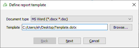

  1. On the Reporting tab, in the Reports group, click the  Define template icon.
    Figure 1. The Define report template dialog.
  2. In the Document type drop-down list, select one of the following:
    • MS Word (*.docx *.doc)
    • MS PowerPoint (*.pptx)
  3. In the Template field, specify the Microsoft template to be used for the report generation.
  4. Click Next.

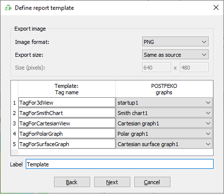

    Figure 2. The Define report template dialog.
  5. In the Image format drop-down list specify the image format.
  6. In the Export size drop-down list select the export size of the images used in the report.
  7. In the table specify the POSTFEKO graph or 3D view for each tag used in the Microsoft template.
  8. Click Next > Done.
