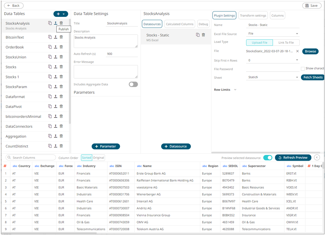

1. Click the Upload Data Table
button
of a data table in the Data Tables list.

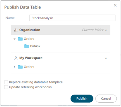

The Publish Data Table dialog displays.
2. You can opt to enter a new Name of the published data table template.
3. Select the folder or subfolder where the data table template will be published .
4. Check the Replace existing datatable template box to replace the previously published data template with the same name to the new one
5. Check the Update Referring Workbooks box to update the workbooks using the data table template.
4. Click
An error message displays if an existing data table with the same name is already available.
Enter
another name and click
. The published
notification message displays.
The published data table template is added on the Data Templates list and can be used when creating other workbooks.
