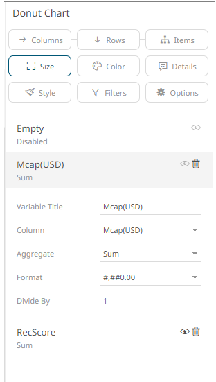

1. On the Visualization Settings pane, click the Size variable. To associate other columns from the data table, drag and drop them to the Size variable drop area. Select one to display the corresponding configuration pane.
2. Enter the label of the Size variable in the Variable Title field.
You can parameterize the variable title to support dynamic schema in the dashboards.
3. You can also change the column to the be used as the Size variable from the Column drop-down list.
4. Specify an aggregation method in the Aggregate field.
The default is Sum.
The Size variable also supports a number of other aggregate types:

5. The Format field lets you specify the format that numbers will be displayed in. Panopticon uses the same formatting rules as Excel.
6. Select the Divide By value to divide a number:
