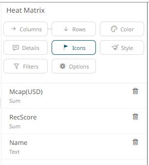

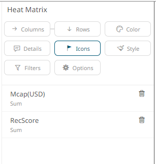

1. To associate columns from the data table, drag and drop them to the Icons variable drop area. Select a numeric column to display the corresponding configuration pane.
This displays the configuration pane.

You can add Icons based on text columns in a similar way.
1. To associate columns from the data table, drag and drop them to the Icons variable drop area. Select a text column to display the corresponding configuration pane.
