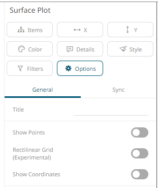

The surface plot settings pane is displayed after clicking the Options  button.
Setting
Show Points
Determines whether surface data points are shown.
Rectilinear Grid
Determines whether distinct X and Y values are changed into a rectilinear grid where missing values are filled in with a default of zero (or the ground level).
Show Coordinates
Determines whether the graph coordinates (i.e., X-Y plots, or Date/Time-Y plots) on mouse over are displayed in the visualization.

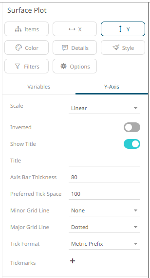

Other visualization-specific properties can be set by clicking on the X-Axis variable drop area and then selecting the X-Axis tab:
Or also, by clicking on the Y-Axis variable drop area and then selecting the Y-Axis tab:
