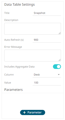

To retrieve external aggregates:
1.     Retrieve your data set including both base data, plus aggregate data.
2.     On the Data Table Settings pane, tap the Includes Aggregate Data slider to turn it on and then select the text column that defines the leaf.
3.   Enter the Value to determine aggregate rows. The default being blank.
4.     Click the Save  button.

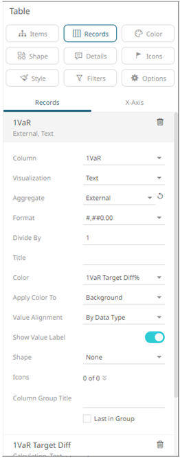

NOTE
Within the visualization, the default aggregation method for all variables will be set to External.
As long as the leaf or lowest level of data is identified by selecting a specific categorical column, multiple non-additive hierarchies can be supported.  In these cases, the aggregates must be supplied, where every column to the left of the selected column, is defined as a potential aggregate.
