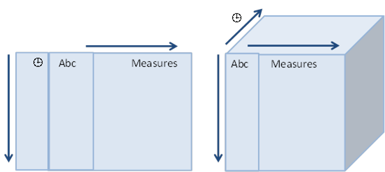

Your source data must be transformed in order to use time series visualization. The transform converts the dataset into a cube, where the Z axis of the cube represents time, providing a set of time slices to play through and calculate across.
When there is a time slice, but not a value determined by the selected dimensions, the value will be set to null, and in the case of a line graph, a gap in the line will be drawn.

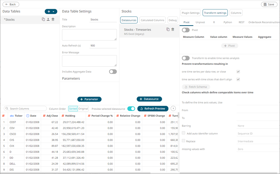

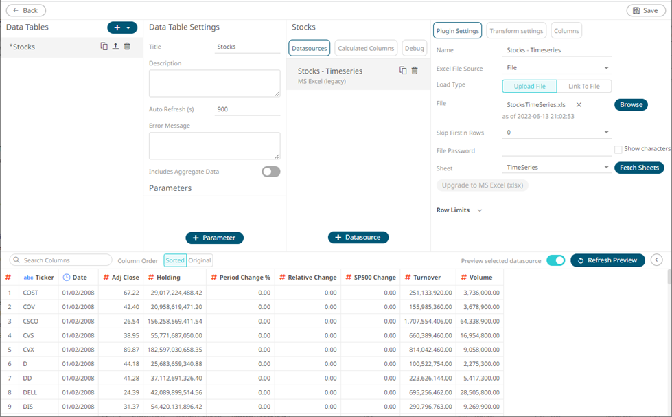

1.     Click on a data source on the Data Sources panel. The currently selected data source is highlighted (grey background).
The corresponding Data Source Settings pane is displayed.
2.     Click the Transform Settings button.
The Transform Settings pane displays.

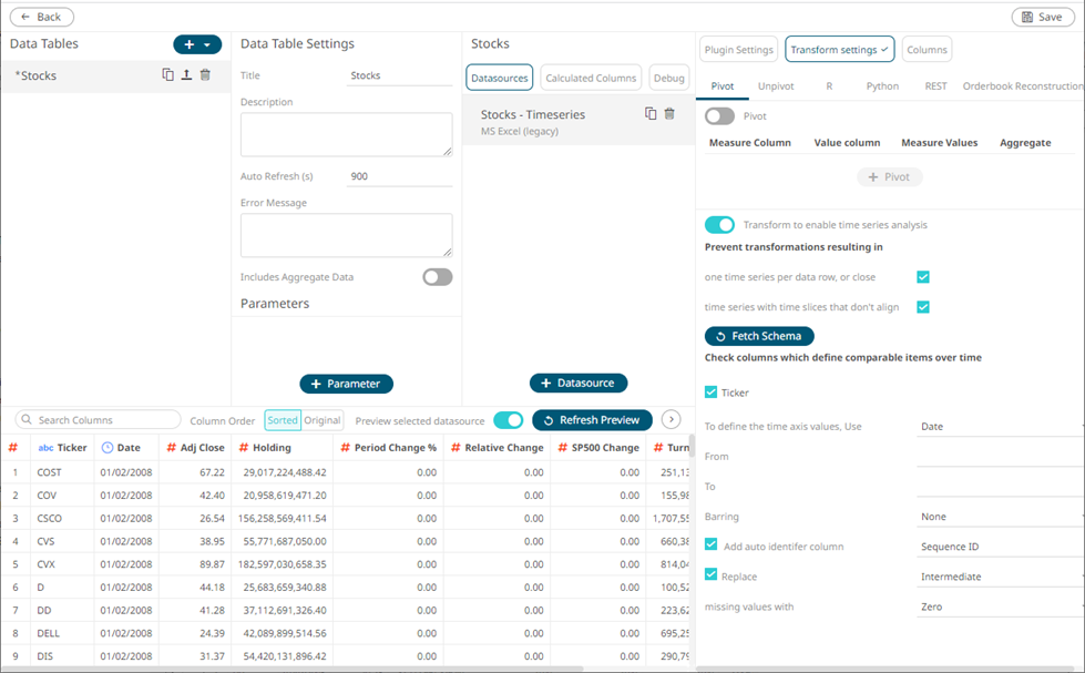

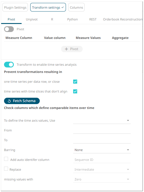

3.     Tap the Transform to enable Time Series analysis slider to turn it on.
   NOTE
Once enabled, the Transform Settings button displays with a check . If the transform leads to change in the schema, the Fetch Schema   button is also enabled.
The check boxes for: one time series per data row, or close and time series with time slices that don’t align, ensure that duplicate values are highlighted, and the time cube volume is minimized.
4.     Click Fetch Schema to update columns available for time series transform.

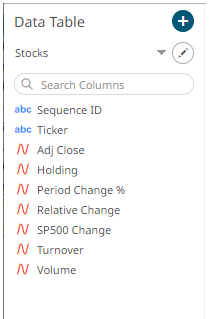

5.     Select the key or compound key columns from the source list of dimensions to define comparable items over time.
These define each series and correspond to the rows of the generated time cube.
6.     Select the column to define the time axis values (Date/Time stamp).
Default value is Date.
7.     Set the Date/Time range of the column set in step 5 in the From and To text boxes.
This filters the time series visualization data causing less data to go over the network to the Web client.

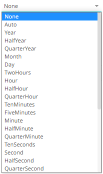

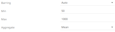

8.     Choose whether you want to Conflate the dataset by setting the Barring period to Auto, or a defined value, between Year and Nanosecond.
Setting the barring period conflates the dataset to a defined granularity, returning a set number of data points, by default being between 50 and 1000 for Auto
As data is potentially being aggregated across time, an Aggregate must be selected.  The default conflation aggregate is Mean. Other options include: Sum, Min, Max, First,  Last and Count.
Barring can be useful to standardize sparse time series which is especially common with sensor data, outputting values at defined time intervals, and potentially minimizing the number of rendered data points.
The available barring periods besides Auto are:
Year, Half Year, Quarter Year, Month, Day, Two Hours, Hour, Half Hour, Quarter Hour, Ten Minutes, Five Minutes, Minute, Half Minute, Quarter Minute, Ten Seconds, Second, Half Second, Quarter Second, Tenth Second, Fifty Milliseconds, Ten Milliseconds, Five Milliseconds, Millisecond, Fifty Microseconds, Ten Microseconds, Five Microseconds, Microsecond, Fifty Nanoseconds, Ten Nanoseconds, Five Nanoseconds, Nanosecond.
However, when the barring period is set to None, you can enable Add Auto Identifier Column: Sequence ID.
This means that when multiple values are processed at the same time along with selected dimensions, the seqid  will be added to each unique occurrence per time slice and defined dimensions, incrementing starting from 1.

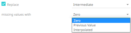

9.     Choose whether you want to interpolate for missing values.
The interpolation can replace missing numeric values with Zero, the Previous Value, or an interpolation between known values (Interpolated).
