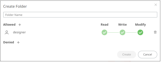

1.     On the Workbooks tab, right-click on the personal folder, and select New Folder.
The Create Folder dialog displays.
NOTE
·         The Designer user is available under the Allowed section by default with Read, Write, and Modify permissions.
·         Removing the Designer user will mean they will not have access to this folder and its subfolders.
2.     Enter a Folder Name.
3.     Proceed to defining the Authorization to Allowed or Denied groups and users.

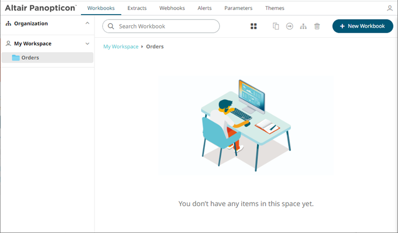

4.     Click  .
The new folder is displayed on the expanded Folder hierarchy list and on the Folders/Workbooks list.
