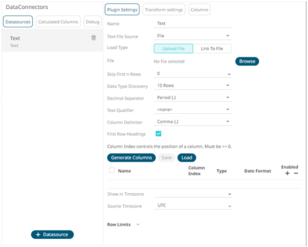

1.     Select Text from the Connectors panel. The Text Settings panel displays.
2.     Enter the Name of the Text data source, then click .
3.     Select the Text File Source.
   NOTE
The Upload File button, when clicked, allows the user to choose files from their own computer. To choose files that resides on the Panopticon Server machine, use the Link to File option and fill in the Text File Path.
The standard settings controlling how the text file is parsed, is listed.
These include:
Property
Skip First N Rows
Specifies the number of rows that will be skipped.
Data Type Discovery
Specifies how many rows from the text file should be used when automatically determining the data types of the resulting columns.
Text Qualifier
Specifies if fields are enclosed by text qualifiers, and if present to ignore any column delimiters within these text qualifiers.
Column Delimiter
Specifies the column delimiter to be used when parsing the text file.
First Row Headings
Determines if the first row should specify the retrieved column headings, and not be used in data discovery.
4.     Click  to the fetch the schema based on the connection details. Consequently, the list of columns with the data type found from inspecting the first ‘n’ rows of the input data source is populated and the Save button is enabled.
5.     You can also opt to load or save a copy of the column definition.
6.     Click to add columns and specify their properties:
Property
Name
Column Index
The column index controls the position of a column. Must be >= 0.
Type
Date Format
Enabled
Determines whether the message should be processed.
To delete a column, check its  or all the column entries, check the topmost , then click .
7.     Date/Time values of output data and Date/Time inputs, where supported, is by default unchanged.
8.     Tap the Preview Selected Data Source slider to turn it on.
9.     Set the row limit of the data set.
10.   Click  to display the data preview.
