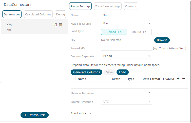

The XML connector allows the retrieval and processing of XML files, either from a disk, a Text, or from a defined URL.
1. Select XML from the Connectors panel. The XML Settings panel displays.
2. Enter the Name of the XML data source, then click
3. Select the XML File Source.
4. Enter the Record XPath which allows the selection of records within the XML document (e.g., //myroot/items/item). This property can be parameterized.
5. Select either the dot (.) or comma (,) as the Decimal Separator.
6. Click
to the fetch the schema based on the connection
details. Consequently, the list of columns with the data type found
from inspecting the first ‘n’ rows of the input data source is populated
and the Save button is enabled.
7. You can also opt to load or save a copy of the column definition.
8. Click
to add columns and specify their properties:
