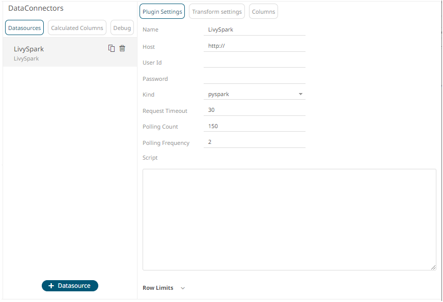

1.     Select LivySpark from the Connectors panel. The LivySpark Settings panel displays.
2.     Enter the Name of the Livy Spark data source, then click .
3.     Enter or select the following properties:
Property
Host
Livy Spark host address.
User Id
User Id that will be used to connect to Livy Spark.
Password
Password that will be used to connect to Livy Spark.
Kind
Currently, the supported kind of connection to be used is pyspark (Interactive Python Spark session).
Request Timeout
Length of time to wait for the server response. Default is 30.
Polling Count
The number of polling done to the Livy Spark server to check if the status of the app is successful. Default limit is 150.
Polling Frequency (in seconds)
Frequency of the polling. Default is 2.
Script
The script to use.
4.     Set the row limit of the data set.
5.     Tap the Preview Selected Data Source slider to turn it on.
6.     Click  to display the data preview.
